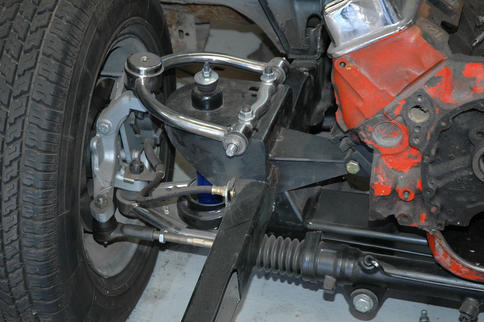

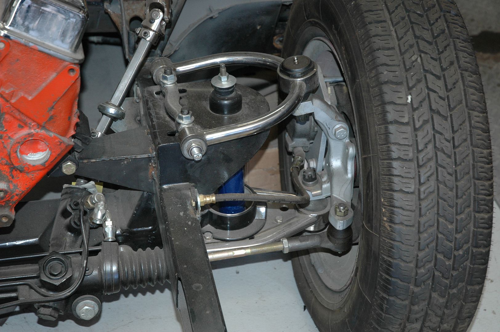

Put on a new power brake booster this one is 7" diameter. The stock GM one was hitting the fender. As it I wll still have to modify the fender for clearance.
Steering Shaft using a SS Borgeson double universal Chevy splined to double D.
I'm using a support in the middle since it has 3 universals in the shaft. Lower universl is a SS Borgeson Mustang II rack to double D

I have already installed a Fatman front subframe and Mustang II suspension with disc brakes. All the suspension is pretty much completed. I just need to pull the body off and finish some frame work the transmission crossmember, run brake and fuel lines, rear shock mounts and clean things up.

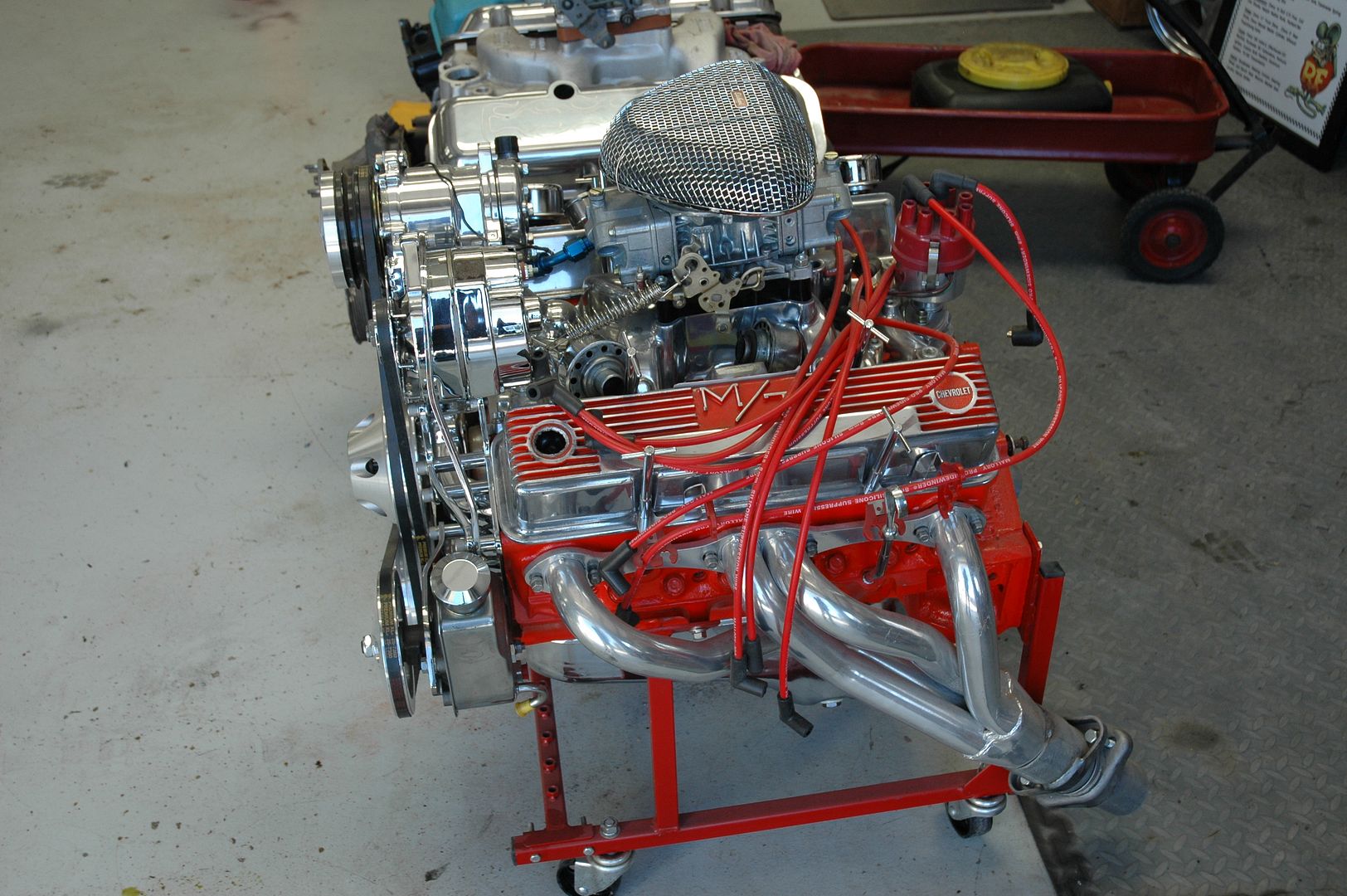

Here is the engine for it. Speedway Motors 406 Chevy.
