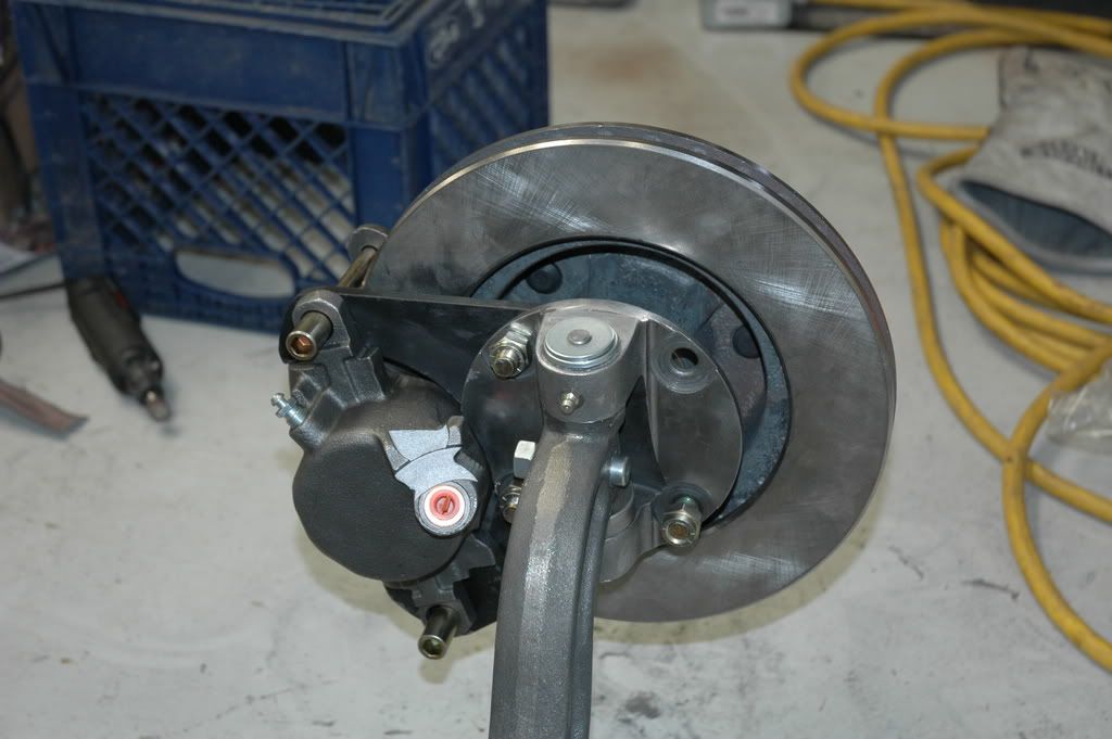

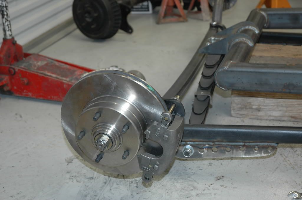

I got the front discs on today too. I would have loved to have put Buick drums on but they are way to expensive. These are 11" Mid-size Chevy discs for 48 Ford spindles. They were only $200 from Speedway
Had a little problem with the inner and out bearings. The diameters were not the same. So I had to break out the Dremel and take a little off the inside of the bearings. The inner was not too bad but the outer bearing and spindle was off by .025". I wasn't sure if they would fit the 14" wheels I had but they cleared no problem.

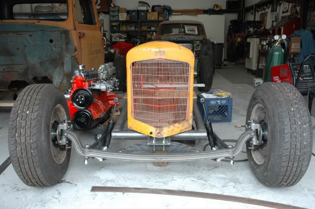

That's a nice clean looking setup dmw56.
  #23
Old 03-08-2008, 08:16 PM
Thanks Gastrick!

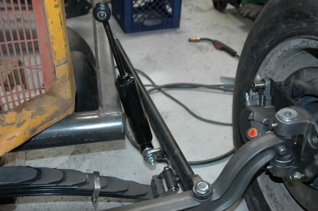

Tomorrow I'll work on shock brackets. I'll mount it on the wishbone bracket just behind the spring mount up to in front of the frame.

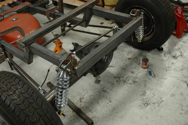

Got some more done on the chassis this week. I had bought a rear end with the brackets already welded on but once I set it up I noticed they were way off. When I put the coil-overs on, the pinion angle was down about 5 degrees and the brackets were off about 5 degrees from each other. So I'm going to send it back! Then I just ordered some radius rod coil-over brackets from Speedway and got them in 3 days and used a 10 bolt 3.73 posi I had for another project.
I still have to weld the Hair pin brackets to the frame.
