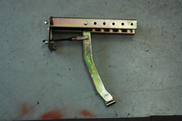

Universal firewall brake pedal and master cylinder mount from swap meet. There wasn't enough room to mount one under the floor on the frame and I don't like them there for several reasons. I had the front licence plate bracket come off of my 50 Stude one time and it bounce under the car and hit the master cylinder breaking the fittings off. Its no fun driving with no brakes!

Good progress and swap meet scores dmw56. I've used those m/c mounts before. I would suggest adding a reinforcement plate to the inside of the firewall to reduce firewall flex around the m/c mount. Obvious I guess but you can off the excess pedal mounting bracket material aft of the hole that you use to mount the pedal.

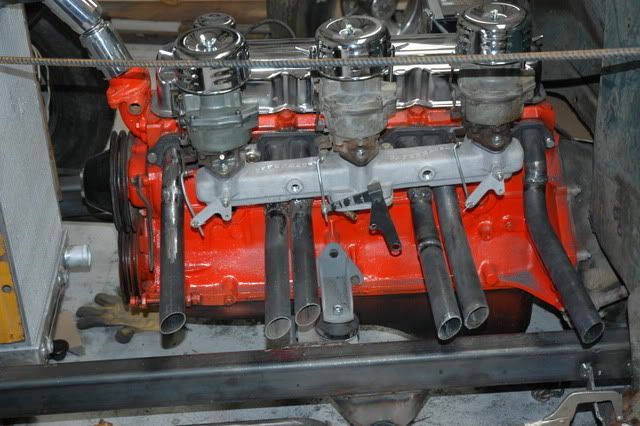

Finished the headers today. I just used the pipes I cut off the headers.
The next step...chop the top, finish steering, brakes, fuel line, electrical, interior floor, seat and then drive it!

I like the bologna cuts on the end of the headers DMW56. The rest of those tasks should only take you a few hours, right?

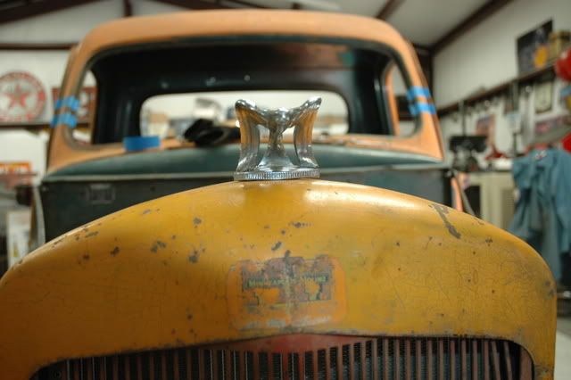

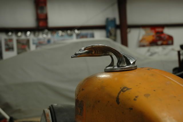

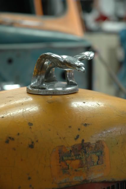

Bought this off Ebay. Said it was off a 30-31 Chevy. I don't know. I liked it and bid on it. I think it looks great!

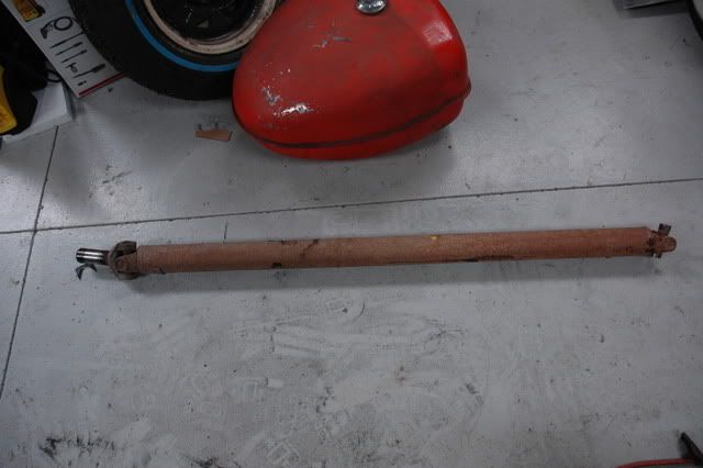

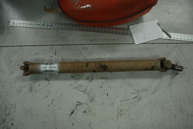

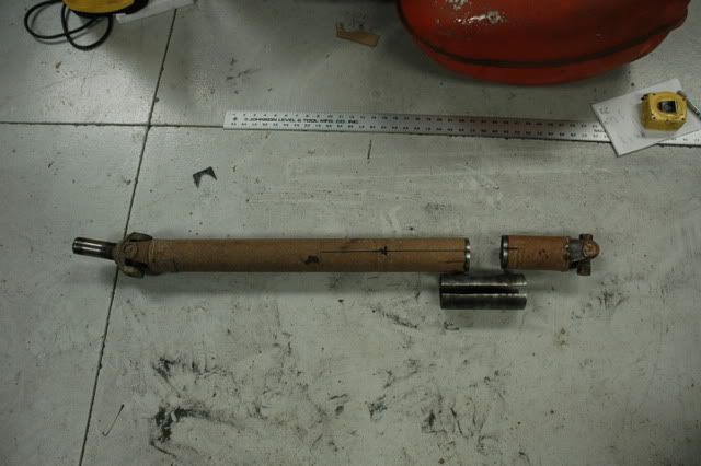

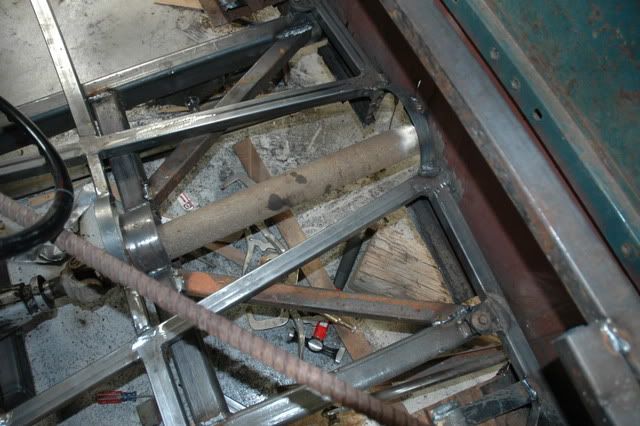

I left work early yesterday and went to the local pick and pay. Its a holiday weekend and there was no one around anyway. Found a drive shaft with the right sized yokes for a TH 350 and 69 Camaro rear only $20. The drive shaft shops here want $100-$150 to shorten it so I decided to do it myself like Bonehead has written about in a post. I running a 250 6 cylinder and an automatic so there won't be a lot of stress on the driveshaft. I needed to shorten it 17 1/2" so I cut that much out of the shaft near the back end and cut of a section about 10"
I marked a line down the side so I could match it up for timing and hopefully it won't be out of balance very much.

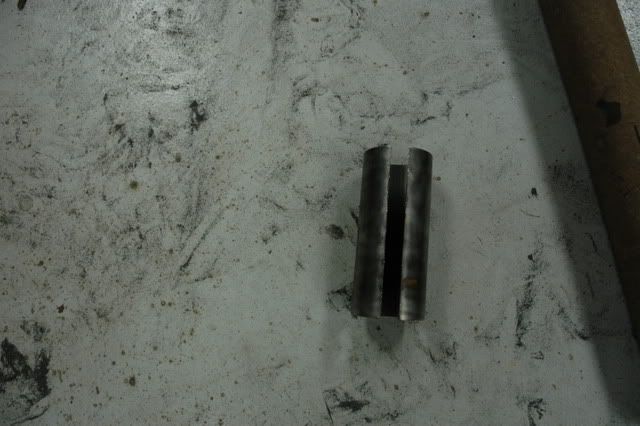

I then cut a 1/2' section out of the 10" piece squeezed it together and put it in the short piece until it bottomed out leaving about 4" left to slide the longer end on. I left about a 3/8" gap and then welded it up.
  #67
Old 05-24-2008, 12:34 PM
I did make it a 3/4" shorter so the seal didn't run on the same spot as before. It looked a little worn there so hopefully it won't leak.

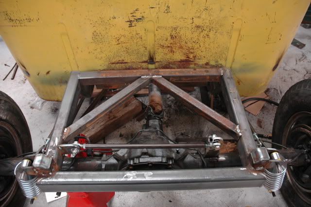

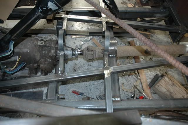

I also welded up a K-brace on the rear section and one in the middle with a drive shaft hoop. I'll put a hoop on the rear also.
I'm probably over building the frame but that comes from the years of dirt track racing and building my own race cars. You could never get them stiff enough!

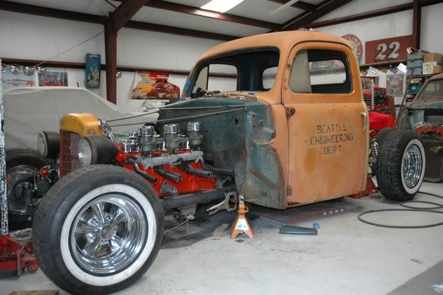

Well I finally got up enough nerve to do the chop. Decided to take out 4" and leave the rear window the original size just drop it down 4" where its level with the windshield and door windows.
It was easier for me to do it in 2 parts so I masked out a line to cut the roof in two.

I cut the roof first with the cut off wheel.
Then I cut the posts with the Sawzal. If you use a Sawzal start out slow because it will cut through the posts real fast.
