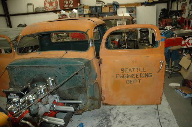

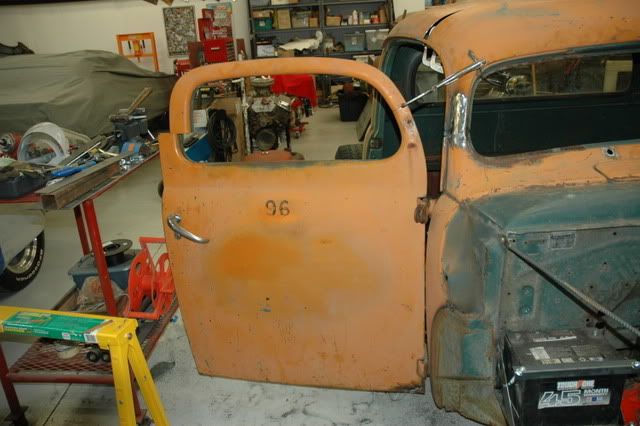

Old 05-26-2008, 06:02 PM
Before
After
Still need to finish fitting the rear section, the section on the roof, the doors and finish up all the welds.

Old 05-26-2008, 06:33 PM
In my opinion, that chop made a substantial difference in the overall proportions of your truck. It looks fantastic.
  #76
Old 05-26-2008, 07:08 PM
Thanks Gastrick! I think it made a big difference also. I think a about a 4' section would look good too. But not willing to try that just yet.

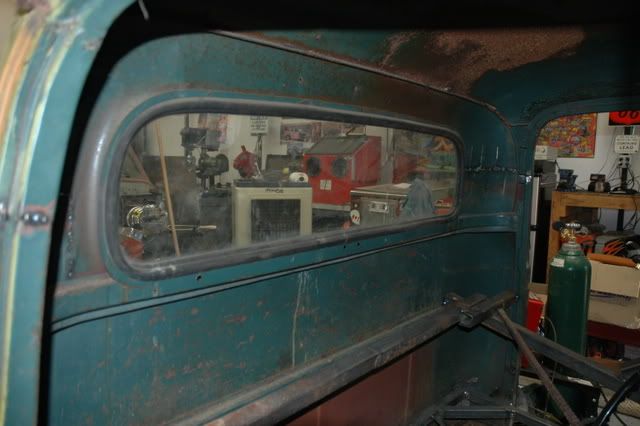

  #79
Old 05-27-2008, 09:00 PM
View of the rear window from inside the cab.
View of the front windshield from inside.

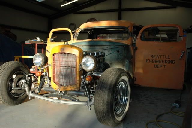

  #80
Old 05-27-2008, 09:05 PM
Set the frames on the doors to what it will look like.
I still need to sand off the paint over the lettering on the passenger side door.
