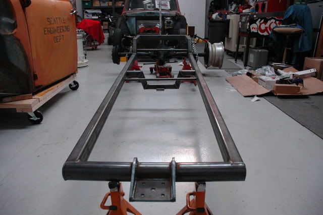

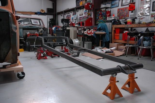

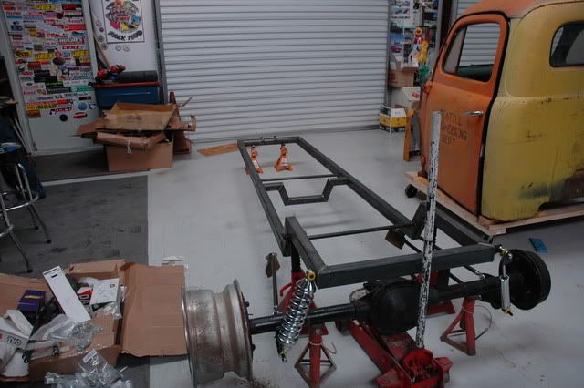

Started the build on my 1951 Ford F1 project. Has a basic 2 X 3X 3/16 frame 26" wide in the front to 31" wide in the rear with a 12" rear kick-up. I have a 48" Super Bell 4" drop I-beam front axle with spring behind hairpin radius rod suicide mount for the front and Coil-over hairpin radius rod rear. The front brakes are 11" Chevy discs on Ford spindles and the rear end is a 10 bolt Posi 3.73 with stock drums.

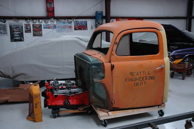

I've posted pictures of the engine before it is a Chevy 250 6 inline with a 3 X 1 Offy manifold. I'm will build straight pipes for ot using the flanges from a header. I have a 350 TH lying around from my Chevelle so I'll use it.
I want to get a rolling chassis done and put the engine and body on the frame just so it takes up less room in the shop and I can move it around. Then I'll get back on the 50 Studebaker project.

Project looks great, and so does your shop. Frame and rear suspension looks right. Rear panhard bar?
Thanks guys. Yeah, I really like my shop too. I promised myself I would have one someday. I can spend a lot of time out there but at least my wife knows where to find me.
Yes, it will have a front and rear panhard bar. I still have to weld all the brackets on the frame. I haven't got my front axle or spring in yet. Should be here next week and then I will get the engine and trans in and set it for ride height and get the radius rod and panhard bar brackets welded on.

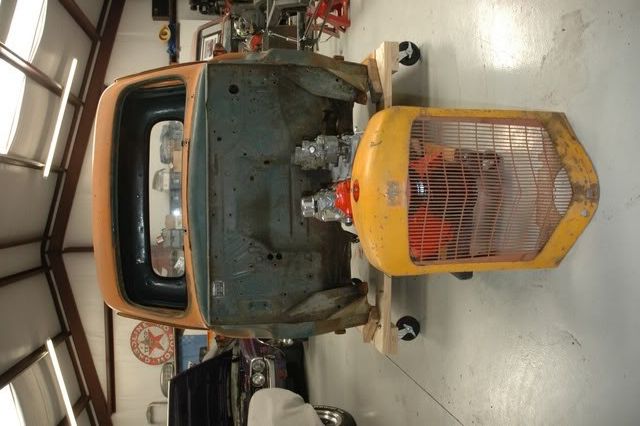

That's a good looking truck! Thanks for the advise on building my cab dolly too. I'm looking forward to lots of pics of your build. What did the grill come from? I like it too.

The grille is from a Minneapolis Moline model Z tractor 1937-1955?. I also have a grille from an Allis Chalmers but I like the MM one better.
